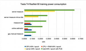

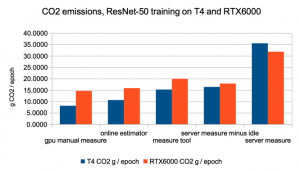

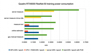

Results are summarized in the following diagrams :
A few comments on these results :
  • GPU consumption estimates are rather near with the different methods. At no surprise, this is the easiest part to estimate insofar as we trust nvidia-smi
  • CPU consumption (and to a lesser extend RAM consumption, when the method shows separate numbers for the two) is far from negligible. Estimation shows more difference depending on the method than for GPU, which may mean real measures are useful for that part.
  • server measure minus idle total kWh / epoch is not so far from those of measure tool and online estimator, which gives some confidence in methods based on GPU/CPU/RAM measure or estimation for computing power consumption overhead.
  • consumption of a the idle server represents a great share of the power consumption. This would represent a smaller part if our testbed used all the capabilities (GPU) of the server.
  • il also means the relative efficiency gain with a low power GPU (T4) is less than the GPU would indicate (70W versus 260W).
